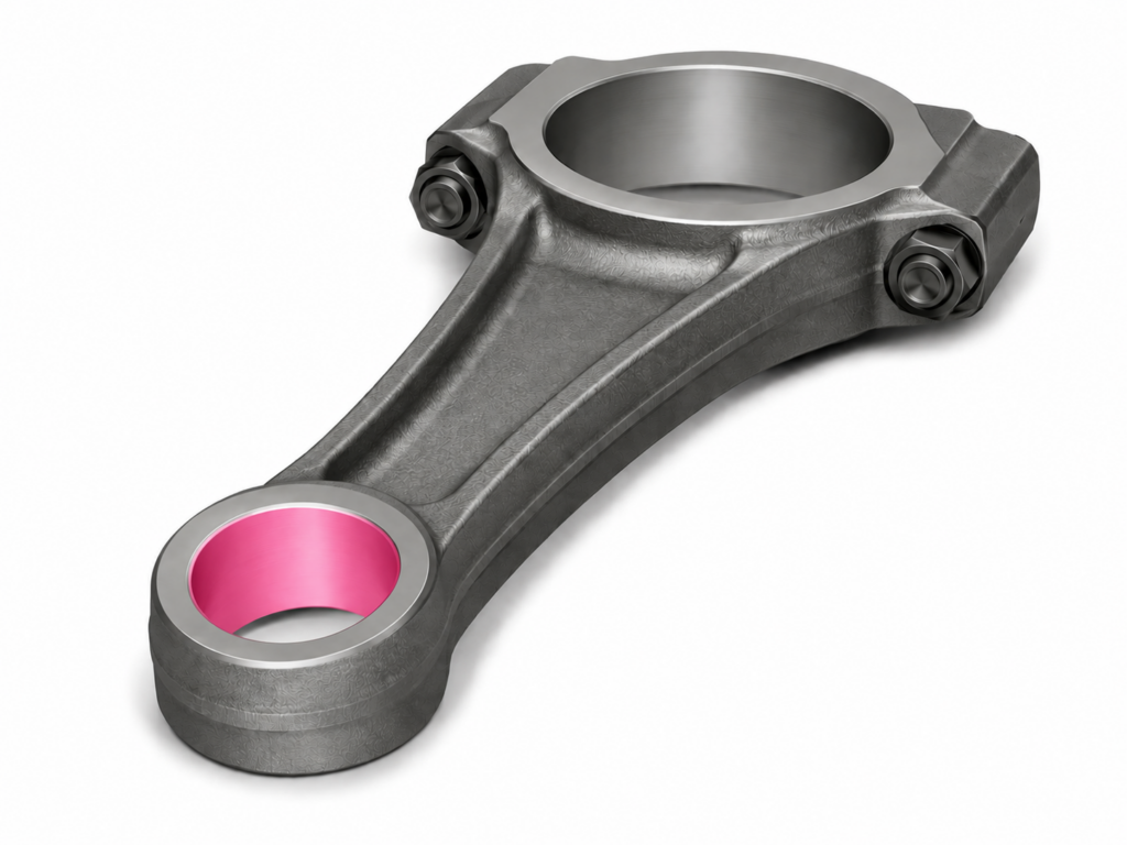

ReamMeister – Hub Wheel – AH725
ReamMeister, despite the use of long overhang setup, provided stable machining with no chatter. As a result, Productivity was increased by 12 times and tool life extended by 1.2 times.
ReamMeister
Industry Heavy
Component Hub wheel
Work material SCM435
Machine(spindle type) Horizontal Machining Center Large(#50,HSK100)
Tool family Holemaking
Tool category Reaming
Product name ReamMeister
TSR No. 1647D
Hub wheel
Body TRM-T6-R16-8 Brazed reamer
Head HRM-16.000-BL-T6 φ16.0, z=6
Grade AH725 PVD, P20
Tool diameter DC (mm) 16 16
Hole tolerance grade H7 H7
Pilot hole diameter (mm) 15.8 15.8
Hole depth H (mm) 18 18
Cutting speed V/c (m/min) 60 15
Feed f (mm/rev) 0.7 0.23
Feed speed Vf (mm/min) 836 70
Coolant Internal coolant Internal coolant
Productivity12 times
Tool life1.2 times
