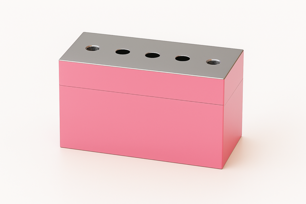

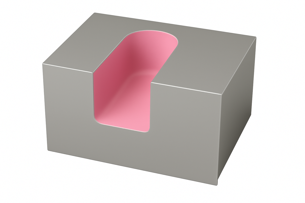

VariableMeister, Positioning part, AH710
IMPROVED PRODUCTIVITY
In finish machining, productivity was previously reduced to achieve high-precision surfaces. However, by using VariableMeister, productivity was significantly increased while maintaining finishing accuracy.
| Component | Positioning part |
| Work material | S50C |
| Machine(spindle type) | Vertical Machining Center Large(#50,HSK100) |
| Tool family | Milling |
| Tool category | Shoulder milling |
| Product name | VariableMeister |
| TSR No. | 5584M |
| Body | TEC100H7-30C10CF-M85 | |
| Number of teeth | 7 | 4 |
| Cutting diameter | 10 | 10 |
| Overhang (mm) | 30 | 30 |
| Grade | AH710 | PVD |
| Cutting speed V/c (m/min) | 150 | 70 |
| Feed per tooth f/z (mm/t) | 0.05 | 0.02 |
| Feed speed Vf (mm/min) | 1671 | 178 |
| Depth of cut ap (mm) | 15 | 15 |
| Width of cut ae (mm) | 1 | 1 |
| Coolant | Air | Air |
