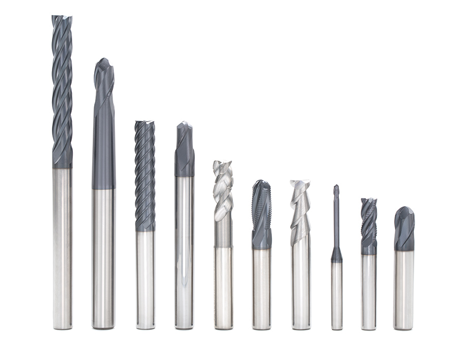

VaribleMeister- Pull stud- AH710
IMPROVED PRODUCTIVITY
Finishing process of the wrench flat area on the pull stud after heat treatment. With VariableMeister 7-flute, it was possible to improve machining efficiency while maintaining finishing accuracy, achieving 2.6 times higher productivity and equivalent tool life, which resulted in high customer satisfaction.

| Product name | VariableMeister |
| TSR No. | 5422M |
| Body | TEC100H7-20C10CF-M72 | |
| Number of teeth | 7 | 4 |
| Cutting diameter | 10 | 10 |
| Overhang (mm) | 20 | 20 |
| Grade | AH710 | PVD |
