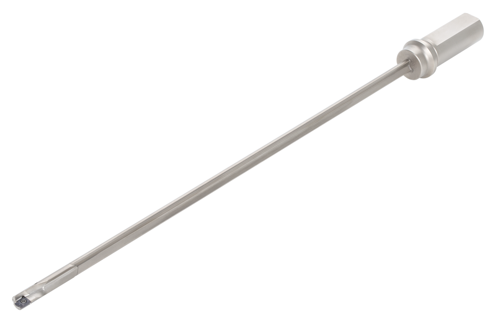

DeepTri-Drill provided 14 times productivity gain over competitor's gun drill. Also eliminated the need for regrinding, simplifying tool management.
DeepTri-Drill
Industry Die & Mold
Component Die block
Work material S50C
Tool family Holemaking
Tool category Deep hole drilling
Product name DeepTri-Drill
TSR No. 5166D
Die block
Body MCTR08.00XM20-25 Blazed gundrill
Insert ZSGT040104R-NDJ
Grade AH9130
Tool diameter DC (mm) 8 8
Hole depth H (mm) 200 200
Cutting speed V/c (m/min) 80 15
Feed f (mm/rev) 0.08 0.03
Feed speed Vf (mm/min) 255 18
Coolant Wet Wet
PRODUCTIVITY14 times
