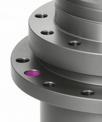

ReamMeister – Stearing arm – AH725
IMPROVED PRODUCTIVITY & STABILITY
Conventional fine-boring cutters faced challenges in machining time and chip evacuation. The multi-flute ReamMeister, combined with high-speed cutting, achieved an 18 times machining efficiency. Moreover, the BL-type left-hand helix design enabled stable machining by preventing chips from tangling around the tool.
