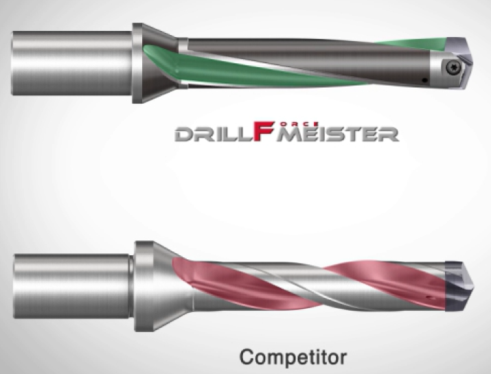

Problem:
Previously, using a competitor's head-exchangeable drill often led to chatter, preventing the increase of cutting conditions.
Solution:
The head-exchangeable drill DrillForce-Meister, equipped with a high-rigidity head clamping system and durable body, achieves stable machining in low rigidity workpiece and has reached a 1.5 times higher machining efficiency.
