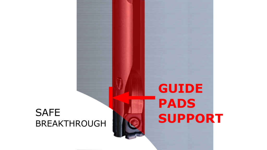

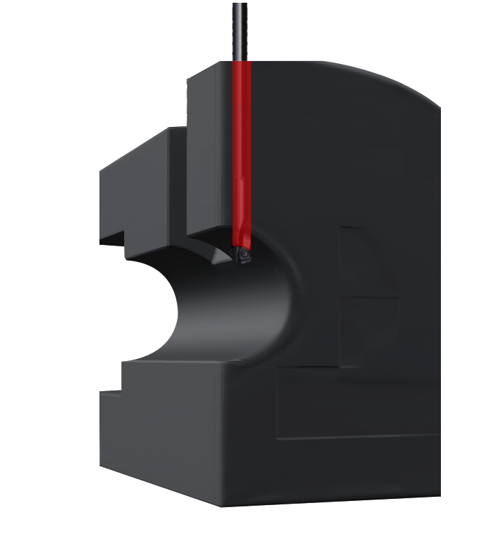

DeepTriDrill significantly boosts productivity and reduces overall costs for drilling operations. Its guide pads ensure stable drilling and safe hole exiting at an angle.
It maintains stable and regular chip formation when drilling S45C steel.
With a feed rate of 223 mm/min, DeepTriDrill doubles productivity compared to conventional brazed gun drills, which were prone to sudden failures and workpiece scrap.
DeepTriDrill offers high stability in chip shape and effective chip discharge, resolving the breakage issues associated with old brazed gun drills.

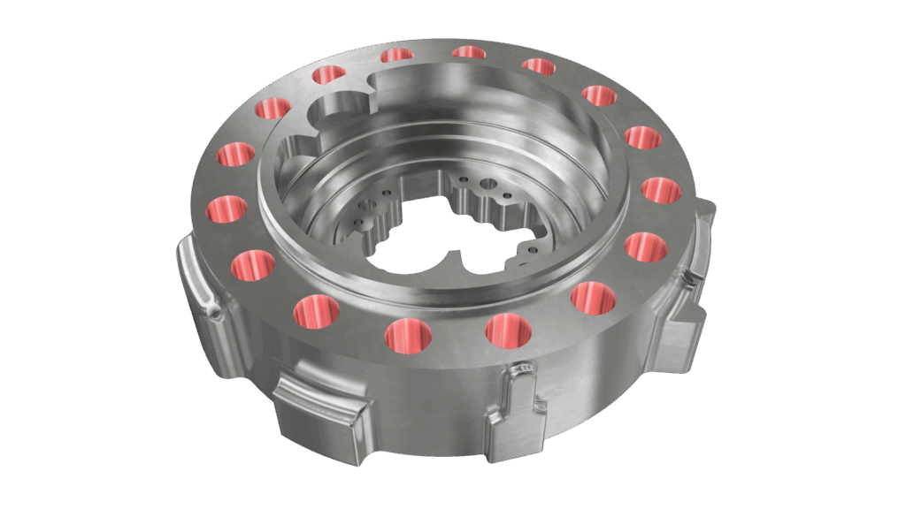

Component Gas control block
