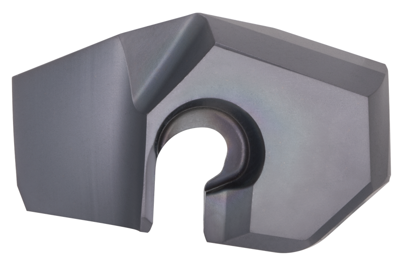

DrillForceMeister –Housing– AH9130
IMPROVE PRODUCTIVITY
DrillForce-Meister achieved 2.2times higher productivity thanks to outstanding entry stability with SMC head and extremely rigid drill design.
There were various workpiece shapes and fixtures, but the ability to machine with a long overhang allowed us to unify the tooling.
Industry | Heavy |
Component | Housing |
Work material | FCD450/GGG45 |
Machine(spindle type) | Vertical Machining Center Large(#50,HSK100) |
Tool family | Holemaking |
Tool category | Drilling |
Product name | DrillForce-Meister |
TSR No. | 5254D |
Tungaloy | Competitor | |
Body | TIS340F40-8 | Head changeable drill |
Head | SMP345 AH9130 | Head |
Grade | AH9130 | PVD |
Tool diameter DC (mm) | 34.5 | 34.5 |
Hole depth H (mm) | 225 | 225 |
Cutting speed V/c (m/min) | 60 | 40 |
Feed f (mm/rev) | 0.3 | 0.2 |
Feed speed Vf (mm/min) | 166 | 74 |
Coolant | Internal Coolant | Internal Coolant |
