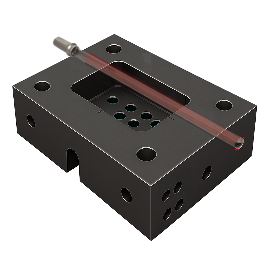

DeepTriDrill Increased productivity and tool life
Boost Your Deep Drilling Efficiency
Increased productivity and tool life for deep hole drilling applications.
When drilling hardened materials such as 440C, this advanced tool outperforms competitors by a substantial margin.
Table feed improved more than 3 times against the brazed gundrill.
It also boasts a remarkable tool life, drilling up to 7 workpieces per corner compared to just 1 workpiece of the competitor
Industry | Die & Mold |
Component | Mold |
Work material | 440C |
Machine(spindle type) | Horizontal Machining Center |
Tool family | Holemaking |
Tool category | Deep hole drilling |
Product name | DeepTri-Drill |
TSR No. | 5160D |
Tungaloy | Competitor | |
Body | MCTR12.00XM20-20 | Brazed Gundrill |
Insert | LOGT060204R-NDJ AH725 | |
Grade | AH725 |
Number of workpieces (pcs/insert) | 7 | 1 |
Tool diameter DC (mm) | 12 | 12 |
Hole depth H (mm) | 230 | 230 |
Cutting speed V/c (m/min) | 57 | 41 |
Feed f (mm/rev) | 0.04 | 0.02 |
Feed speed Vf (mm/min) | 60 | 22 |
Coolant | Water Soluble | Water Soluble |
