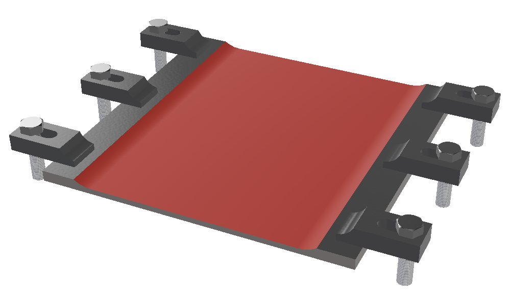

MillQuadFeed09 – Stainless Cast Steel – Flat Top Inserts
IMPROVED TOOL LIFE & PRODUCTIVITY
The inserts from other manufacturers experienced breakage during machining, leading to downtime and reduced productivity.
In contrast, the MillQuadFeed flat top inserts feature a negative land cutting edge design with excellent chipping resistance and a large cross-sectional area, minimizing sudden chipping and breakage.
As a result, they deliver approximately 4.0 times the tool life and a 1.1 times improvement in machining efficiency compared to competing products.
MillQuadFeed
Industry Engineering
Component Housing
Work material X2CrNiMoN22-5-3
Machine(spindle type) Vertical Machining Center Large(#50,HSK100)
Tool family Milling
Tool category High feed milling
Product name MillQuadFeed
TSR No. 5108M
Housing
Body EXSW09M032C32.0R04 High feed cutter
Number of teeth 4 2
Cutting diameter 32 (1.26") 28 (1.10")
Overhang (mm) 70 (2.76") 70 (2.76")
Insert SWMW0904ZSR square insert
Number of cutting edges 4 4
Grade AH8015 PVD
Cutting speed V/c (m/min) 101 (331sfm) 160 (525sfm)
Feed per tooth f/z (mm/t) 0.5 (.020ipt) 0.5 (.020ipt)
Feed speed Vf (mm/min) 2,009 (79.1ipm) 1,819 (71.6ipm)
Depth of cut ap (mm) 0.5 (.020") 0.5 (.020")
Width of cut ae (mm) 20 (.787") 20 (.787")
Coolant Air Air
Tool life4 times
Productivity1.1 times
