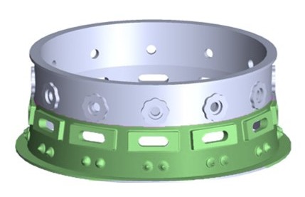

DoOcto
Industry Engineering
Component Pump Housing
Work material Alloyed Cast Iron
Tool family Milling
Tool category Face milling
Product name DoOcto
TSR No. 451M
Pump Housing
Body TAN07R400U015A07 Face mill
Effective number of teeth 7 7
Cutting diameter 101.6 101.6
Insert ONMU0705ANPN-MJ Square type positve insert
Number of cutting edges 16 4
Grade T1215 CVD
Cutting speed V/c (m/min) 366 351
Feed per tooth f/z (mm/t) 0.25 0.2
Feed speed Vf (mm/min) 2036 1561
Depth of cut ap (mm) 2.5 2
Width of cut ae (mm) 76.2 76.2
Coolant Dry Dry
Productivity1.6 times
Tool life1.5 times
