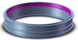

Industry | Automotive |
Component | Bearing |
Work material | S45C |
Tool family | Turning |
Tool category | Internal turning |
Product name | AM-Chipbreaker |
TSR No. | 441T |
Tungaloy | Competitor | |
Holder | A25R-PCLNR12-D320 | A25R-PCLNR12-D320 |
Insert | CNMG120408-AM | CNMG120408-Medium chip breaker |
Grade | T9225 | CVD(P25) |
Cutting speed V/c (m/min) | 150 | 150 |
Feed f (mm/rev) | 0.25 | 0.14 |
Depth of cut ap (mm) | 1.5 | 1.5 |
Coolant | wet | wet |
