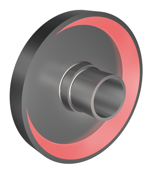

IMPROVED CHIP CONTROL & TOOL LIFE
NEW 4 coolant holes TinyMiniTurn sleeve and EPGT..JS geometry insert enabled better chip control. As the result, solved the chip jamming in all 3 type of material. In addition, tool life was increased 1.5 times with 1.1 times productivity increase.
TinyMini-Turn
Industry Miniature
Component Valve body seat
Work material SUM22L
Tool family Turning
Tool category Internal turning
Product name TinyMini-Turn
TSR No. 1667T
Valve body seat
Holder E07060-SEXPR04-5
Sleeve JBBS20-7-L100C-4N
Insert EPGT040101F-JS Solid boring bar
Grade SH725 PVD
Cutting speed V/c (m/min) 55 50
Feed f (mm/rev) 0.01 0.01
Depth of cut ap (mm) 0.05 0.05
Coolant Internal supply External supply
Productivity1.1 times
Tool life1.5 times
