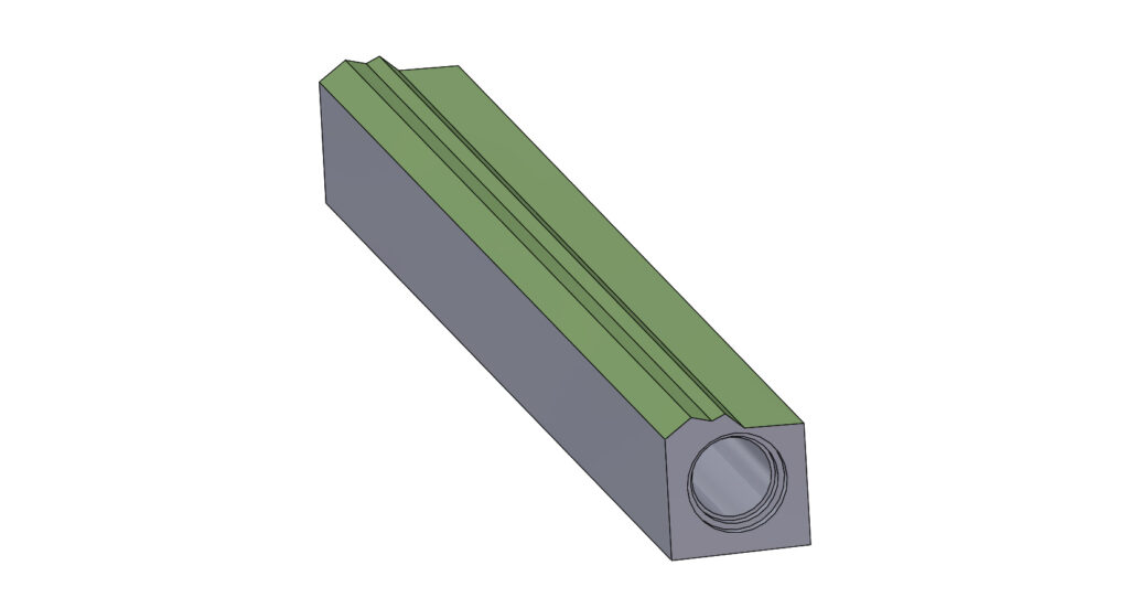

IMPROVED PRODUCTIVITY IN SEMI-FINISH MACHINING OF MACHINE FRAME
High Productivity
- As a standard process, customer requiredfinish milling after Roughing by a high-feed product. In this case, the DoFeed wiperinsert provides excellent surface quality which eliminates finishing process,reducing the total machining time from 4 hours to 1 hour.

Component Machine frame
Work material X5CrNi18-10
Machine(spindle type) Vertical Machining Center
Tool family Milling
Tool category Face milling
Product name DoFeed
TSR No. 393M
Machine frame
Body TXN06R080M31.7-08 High feed cutter
Effective number of teeth 8 8
Cutting diameter 80 200
Insert LNMU06X5ZER-MJ Square type positive insert
Number of cutting edges 8 8
Grade AH725 PVD
Cutting speed V/c (m/min) 100 100
Feed per tooth f/z (mm/t) 0.4 0.13
Feed speed Vf (mm/min) 1280 170
Depth of cut ap (mm) 0.5 0.5
Width of cut ae (mm) 60 120
Coolant Wet Wet
Productivity3.7 times
