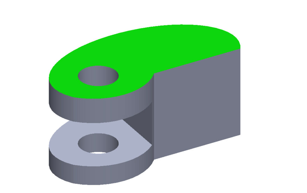

Work material NAK80
Machine(spindle type) Vertical Machining Center Middle(#40,HSK63)
Tool family Milling
Tool category Face milling
