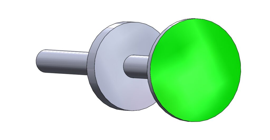

Industry | Automotive |
Component | Shaft |
Work material | Alloy steel |
Machine(spindle type) | Vertical Machining Center |
Tool family | Milling |
Tool category | Face milling |
