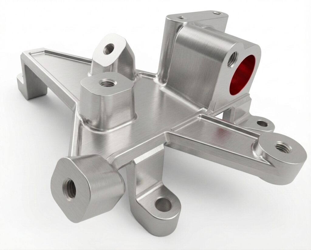

TungDrillTwisted – Die Parts – AH725
IMPROVED PRODUCTIVITY
- PVD coated grade AH725 demonstrates 2 times longer tool life than the competitor’s due to its high wear resistance even when dry machining.
- DJ chipbreaker with low cutting force provides stable chip control on carbon steel even in dry machining.
| Industry | Die & Mold |
| Component | Mold Parts |
| Work material | C45 |
| Tool category | Drilling |
| Product name | TungDrillTwisted |
| TSR No. | 094D |
| Body | TDX200F25-3 | Indexable drill |
| Insert | XPMT06X308R-DJ | Square type insert |
| Grade | AH725 | PVD |
| Tool diameter DC (mm) | 20 | 20 |
| Hole depth H (mm) | 86 | 86 |
| Feed f (mm/rev) | 0.15 | 0.15 |
| Coolant | Wet | Wet |
