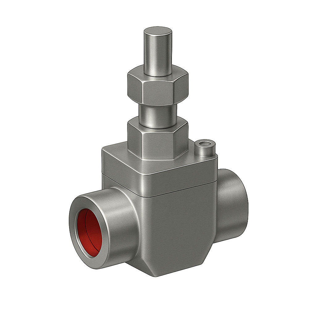

Work material 100Cr6
Machine(spindle type) Vertical Machining Center
Tool family Holemaking
Tool category Drilling
Product name TungSix-Drill
TSR No. 178D
Food Machine
Body TDS390F40-2 Indexable drill
Insert WWMU11X512R-DJ Square type insert
Grade AH9030 PVD
Tool life (m/insert) 15.6 6.8
Tool diameter DC (mm) 39 39
Hole depth H (mm) 55 55
Cutting speed V/c (m/min) 180 160
Feed f (mm/rev) 0.1 0.08
Feed speed Vf (mm/min) 147 105
Coolant Water soluble(Internal) Water soluble(Internal)
Drilling length2.3 times
