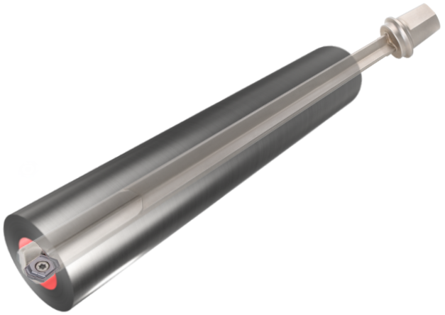

DeepTriDrill – Mold Base – AH9130
superior chip control eliminate fracture.
DeepTriDrill lead to increased productivity 7-fold.
The unique NDJ chip splitters are key, breaking chips into small, manageable segments which ensures smooth chip evacuation allowing for a continuous, uninterrupted drilling process. Prevents fractures that occur with competitor tool.
The enhanced stability and performance result in a more efficient process and lower operational expenses.
Improved table feed rate, from 15 mm/min to 119 mm/min. Is a clear indicator of the superior performance and efficiency of this tool.
| Industry | Die & Mold |
| Component | Mold Base |
| Work material | 1.2083 |
| Material hardness | 25HRC |
| TSR No. | 5185D |
| Body | MCTR08.00XM20-25 | SOLID CARBIDE DRILL |
| Insert | ZSGT040104R-NDJ AH9130 | SOLID CARBIDE |
| Grade | AH9130 | PVD |
| Tool diameter DC (mm) | 8 | 8 |
| Hole depth H (mm) | 120 | 120 |
| Cutting speed V/c (m/min) | 50 | 12 |
| Feed f (mm/rev) | 0.06 | 0.03 |
| Feed speed Vf (mm/min) | 119 | 15 |
| Coolant | WATER SOLUBLE | WATER SOLUBLE |
