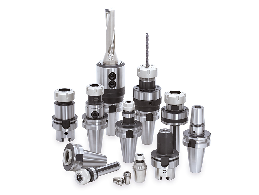

The long drill setup was time-consuming, and reducing machine downtime was an issue. In particular, a lot of time was required to achieve a runout accuracy of 5 µm for long protrusion tools.
By proposing the Hydro Holder, which can clamp tools only by tightening screws, high-precision mounting became possible, and the tool setup time was significantly reduced from 10 minutes to 0.5 minutes.
This has reduced machine downtime and realized more efficient machining.
