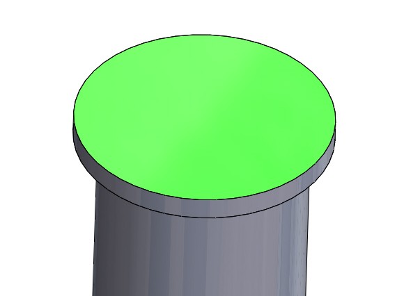

MillQuadFeed-UER inserts generated low cutting heat due to the chip thinning effect of the its small entering angle, eliminating edge fracture. Hence, cutting parameters were increased resulting 9 times productivity boost.
