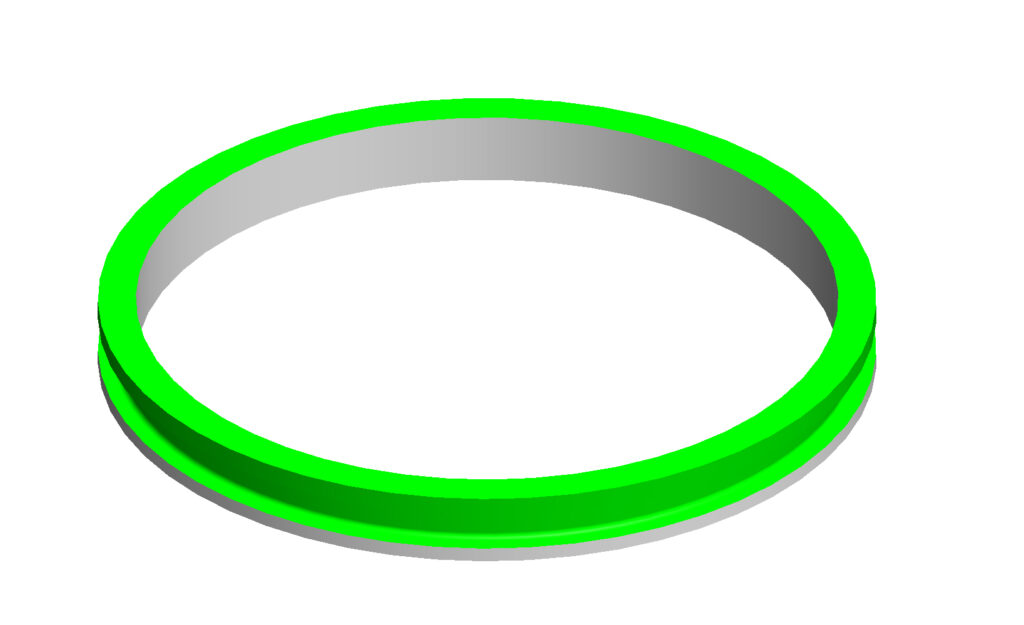

GNGA insert with a 70゚nose angle, combined with L style (S01315) edge prep, enabled light cutting, while BXA20 grade provided increased wear resistance. GNGA insert eliminated the formation of white layer* on the finished surface, while providing 7 times better tool life. *Phase transformation of the machined workpiece surface caused by mechanical and thermal impact inflicted during turning or grinding operation.

Gear housing
Holder ACLNR2525M12-A ACLNR2525M12-A
Insert 2QP-GNGA120404-L CNGA120404
Grade BXA20 Uncoated CBN(H20)
Tool life (pcs/edge) 147 21
Cutting speed V/c (m/min) 200 200
Feed f (mm/rev) 0.15 0.15
Depth of cut ap (mm) 0.2 0.2
Coolant Wet Wet
Tool life7 times
