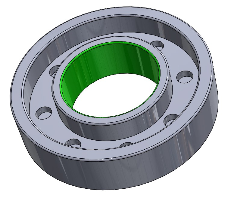

Out of 100 parts, 1 - 2 that were machined with the competitor's CBN chipbreaker insert resulted in chip bird-nesting. BXA20 with HS chipbreaker eliminated chip bird-nesting.
| Component | Automotive parts |
| Work material | SCM420 |
| Product name | BXA20 |
| TSR No. | 5326T |
| Insert | 2QP-CCGT060204-HS | |
| Edges par insert | 2 | |
| Grade | BXA20 |
| Cutting speed V/c (m/min) | 130 | |
| Feed f (mm/rev) | 0.25 | |
| Depth of cut ap (mm) | 0.2 | |
| Coolant | Wet |
