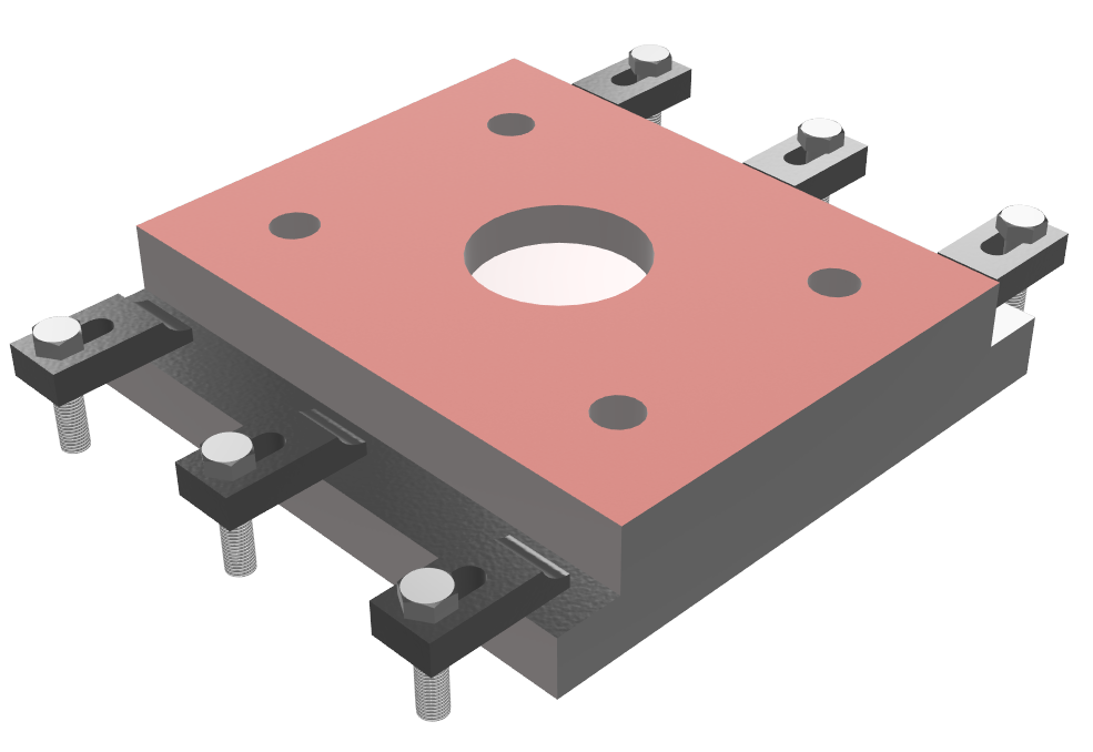

MillQuadFeed15 – Plastic injection mold – Flat Top Inserts
With high load resistant cutting edges, MillQuadFeed flat top inserts demonstrated little edge chipping.
As the result, tool life increased by 1.2 times over the competitor square positive inserts.
Industry | Automotive |
Component | Mold |
Work material | Pre-hardened steel |
Machine(spindle type) | Horizontal Machining Center Large(#50,HSK100) |
