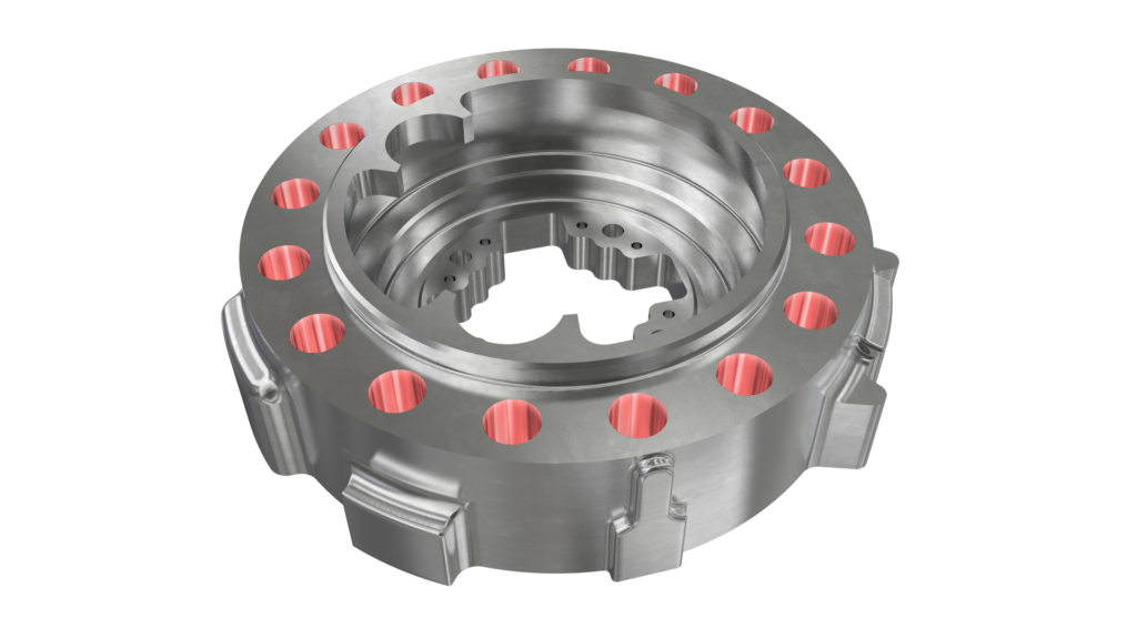

DrillForceMeister – construction machinery parts – AH9130
IMPROVED PRODUCTIVITY
SMC head enables stable machining due to its unique cutting edge design, which provides excellent biting performance. The increased stability allows for higher feed rates compared to the current products.This tool is suitable for construction equipment parts.
| Industry | Heavy |
| Component | Axle housing |
| Work material | FCD700 |
| Machine(spindle type) | Horizontal Machining Center Large(#50,HSK100) |
| Tool category | Drilling |
| TSR No. | 5031D |
| Body | TIS270F32-8 | Head exchangeable drill |
| Head | SMC270 | Drill head |
| Grade | AH9130 | PVD |
| Tool diameter DC (mm) | 27 | 27 |
| Hole depth H (mm) | 154 | 154 |
| Cutting speed V/c (m/min) | 40 | 20 |
| Feed f (mm/rev) | 0.3 | 0.4 |
| Feed speed Vf (mm/min) | 141 | 94 |
| Coolant | internal coolant | internal coolant |
