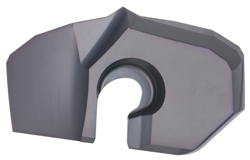

DrillForceMeister provided 8 times longer tool life thanks to its highly wear resistant AH9130 grade and 5 times higher productivity thanks to SMC self-centering cutting edge and rigid head clamping.
In addition, the use of head-changeable drills eliminated the need for re-grinding.
Easier tool management because there is no need to modify the machine program after regrinding and only new drill head needs to be replaced.
DrillForce-Meister
Industry Heavy
Component Control Valve
Work material FCD600
Machine(spindle type) Horizontal Machining Center Large(#50,HSK100)
Tool family Holemaking
Tool category Drilling
Product name DrillForce-Meister
TSR No. 5192D
Control Valve
Body TIS260F32-8 HSS drill
Head SMC260
Grade AH9130 PVD
Tool life (m/insert) 40 5
Tool diameter DC (mm) 26 26
Hole depth H (mm) 100 100
Cutting speed V/c (m/min) 60 20
Feed f (mm/rev) 0.2 0.12
Feed speed Vf (mm/min) 147 29
Coolant Internal Coolant Internal Coolant
PRODUCTIVITY5.0 times
TOOL LIFE 8 times
