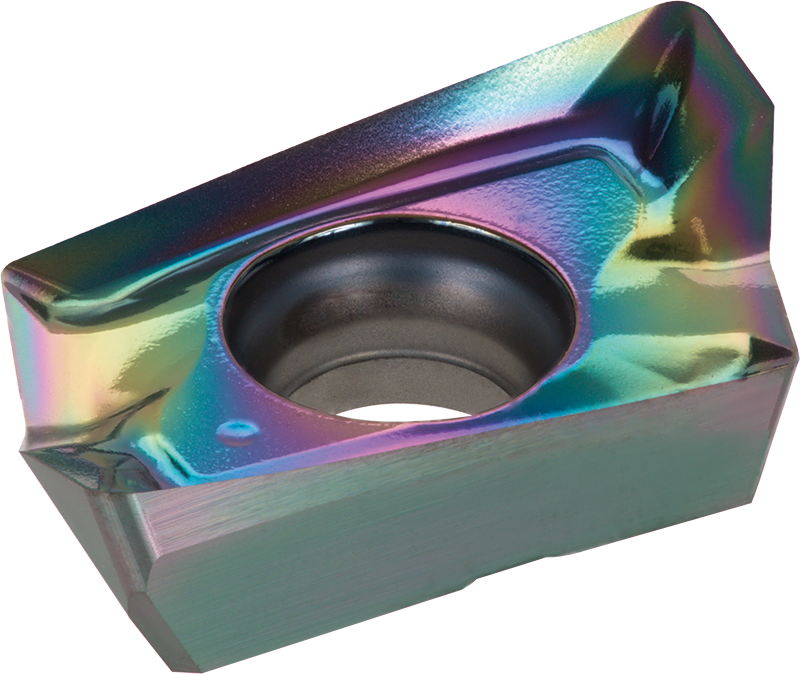

COST REDUCTION & IMPROVED PRODUCTIVITY
Thanks to the sharp cutting edge of TungForceRec and the high resistance to welding of the DS2005 DLC coating, excellent surface finish was achieved. This has significantly reduced tooling costs and improved machining efficiency compared to previous process.
