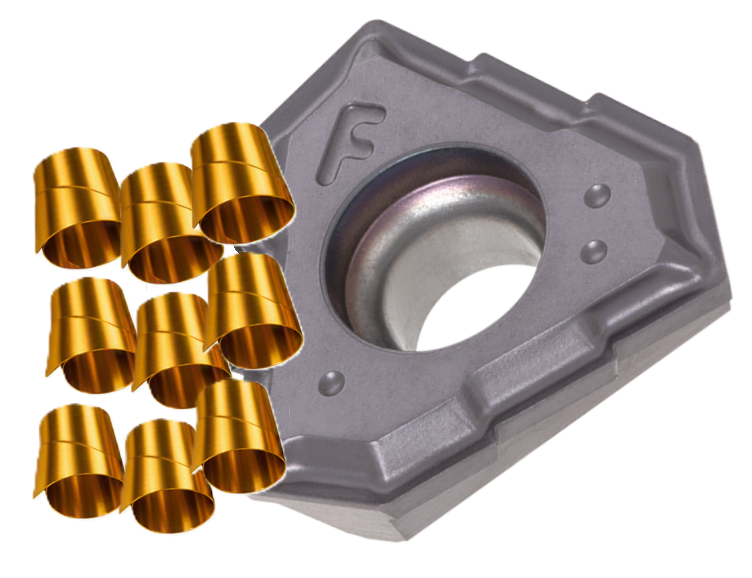

IMPROVED PRODUCTIVITY
Compared with brazed gun drills, DeepTriDrill enables more than two times higher productivity by finely breaking chips and ensuring smooth chip evacuation.
