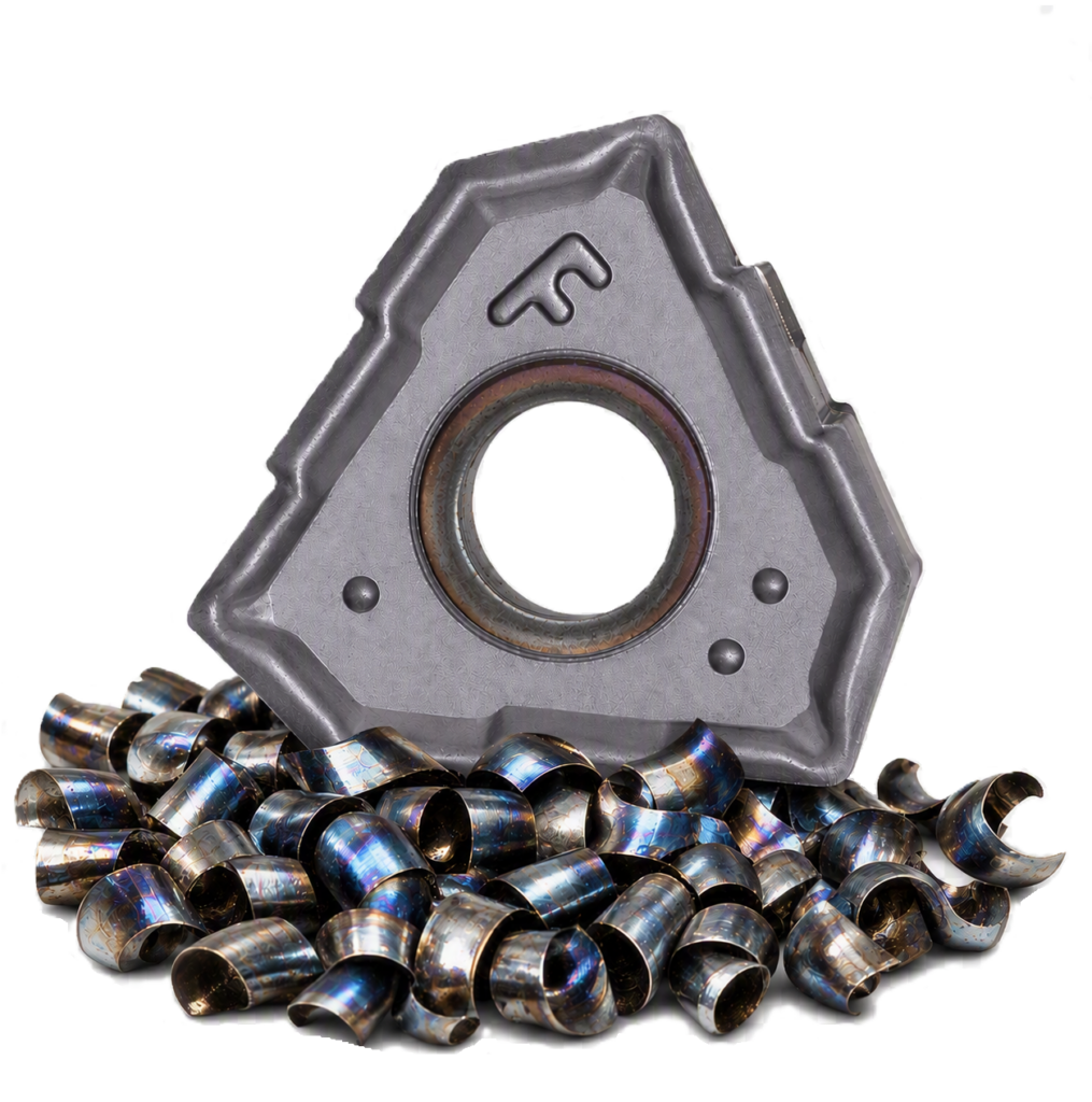

Drilling Ø32 mm × 600 mm deep holes in AISI/SAE 1045 H (230 HB) with conventional tools means drilling from both sides — poor finish, misalignment, and frequent insert changes.
DeepTriDrill with AH725 grade solves this in a single pass.
10× tool life — 20 holes per edge vs. 2
35% faster — 215 mm/min at 120 mm/min
Single-pass H8 tolerance — no secondary finishing operations.
3-edge insert — extermely lower cost per cutting edge
