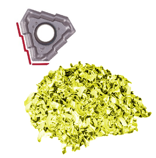

Achieve Cost-Effective Deep Drilling with Innovative Solutions
Productivity Savings Drilling Copper.
The solution features improved cutting conditions, resulting in a 65% cost reduction per part.
The enhanced productivity savings are realized through fewer tool changes and extended tool life.
Swarf exhaustion is excellent, chips are short and tigh. Overall drilling operaiton is very stable.
Customer is satisfied with the high metal removal rate and a quick return on investment.
