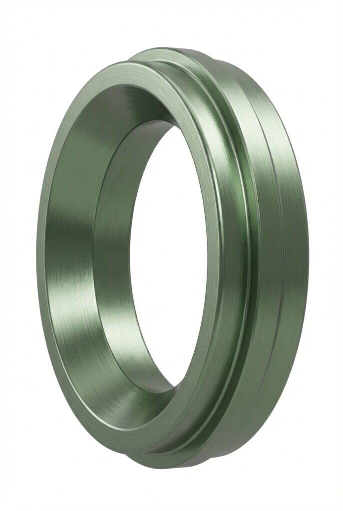

In internal turning of automotive parts, increased machine downtime due to chip problem was big problem. Customer requested cost reduction and improved chip control. Testing Mini Force Turn of double-sided positive inserts revealed that in achieved more stable tool life and superior chip control compared to the competitor’s ISO inserts, resulting in significant reduction in machine down time! Furthermore, the number of corners doubled, leading to cost reductions.
Mini Force Turn is Tungaloy’s unique products that achieves performance equivalent to or better than conventional ISO while also reducing costs.
| Component | Automotive parts |
| Work material | STKM |
| Product name | MiniForce-Turn |
| TSR No. | 5633T |
| Holder | A16Q-SCLXR06-D180 | standard tool holder |
| Insert | CXMU060304L-TS | CPMH090304-finish breaker |
| Edges par insert | 4 | 2 |
| Grade | T9225 | CVD P25 grade |
| Tool life (pcs/edge) | 150 | 100 |
| Cutting speed V/c (m/min) | 230 | 230 |
| Depth of cut ap (mm) | 0.3 | 0.3 |
| Coolant | Wet | Wet |
