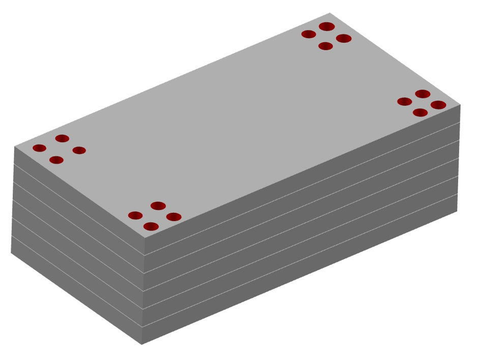

| Industry | Agriculture |
| Component | Machine Parts |
| Work material | SS400 low carbon steel |
| Machine(spindle type) | Vertical Machining Center Middle(#40,HSK63) |
| Tool category | Drilling |
| TSR No. | 5615D |
| Body | TIS240F25-3 | Indexable drill |
| Head | SMF245 AH9130 | Insert |
| Grade | PVD | PVD |
| Tool life (m/insert) | 2.9 | 1.9 |
| Tool diameter DC (mm) | 24.5 | 24.5 |
| Hole depth H (mm) | 6 | 6 |
| Cutting speed V/c (m/min) | 70 | 70 |
| Feed f (mm/rev) | 0.15 | 0.05 |
| Feed speed Vf (mm/min) | 136 | 46 |
| Coolant | External Coolant | External Coolant |
