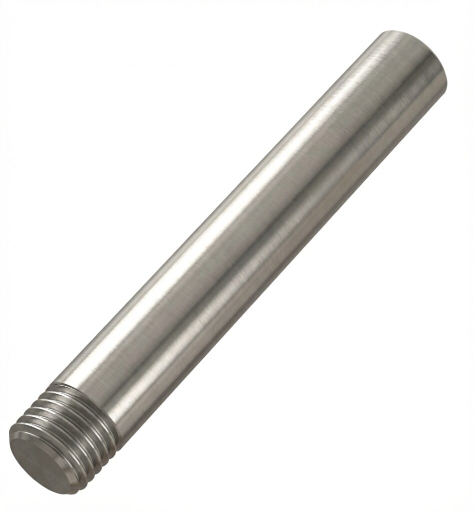

Extends tool life by 4 times compared to the competitor due to the strengths of: - TungJet: Prevents flank wear with normal pressure coolant supply from frontal coolant hole - SW chipbreaker: Delivers low cutting force. Stable chip control- Delivers stable chip control in stainless steel machining due to: - TungJet: Forms short chips by its cooling effect - SW chipbreaker: Designed with newly developed “Two-step bottom”.
TungTurn-Jet
Industry Automotive
Component Nut Parts
Work material SUS440/X70CrMo15
Tool family Turning
Product name TungTurn-Jet
TSR No. 432T
Nut Parts
Holder PCLNR2525M12-CHP ACLNR2525M1-A
Insert CNMG120408-SW CNMG120408-Medium chip breaker
Grade T9205 CVD(M25)
Cutting speed V/c (m/min) 150 150
Feed f (mm/rev) 0.25 0.25
Depth of cut ap (mm) 1 1
Coolant Wet Wet
Tool life4 times
