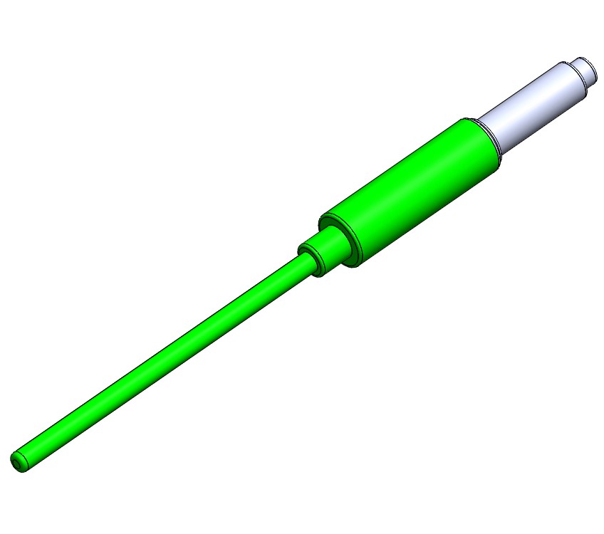

Industry Oil & Gas
Component Valve
Work material Hastelloy X
Tool family Turning
Product name BXM10
TSR No. 046T
Valve
Insert 2QP-DNGA150408 DNGA150408
Grade BXM10 Coated CBN(H10)
Tool life (pcs/edge) 7 5
Cutting speed V/c (m/min) 200 200
Feed f (mm/rev) 0.1 0.1
Depth of cut ap (mm) 0.2 0.2
Coolant Water soluble Water soluble
Tool life1.4 times
