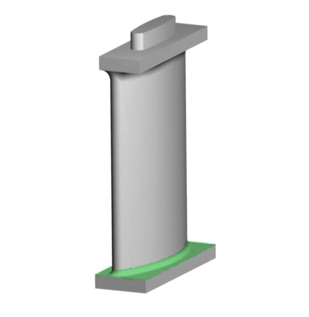

High MMR and stable tool life: The customer was using a shoulder mill at a low table feed with a large DOC. Due to MillQuadFeed’s high-feed capability, an MMR in the same process has improved by 1.7x that of the competitor’s. Thanks to its robust cutting edge, MillQuadFeed stabilized tool life, eliminating unexpected tool fractures as with the case of the competitor’s inserts.

Industry Power Generation
Component Casing
