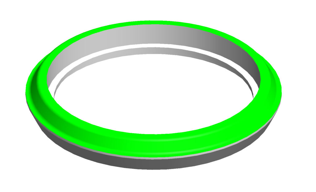

Component Plunger Solenoid
Work material ELCH2
Tool family Turning
Tool category Face turning
