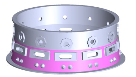

Customer problem
-The customer is machining the component with long overhang: 125mm (L/D=2.5). He had issues of chattering with competitor tools.
High productivity
-Tung-Tri’s design offers low cutting force due to sharp rake face with anti-chatter feature, hence performing smoothly without chattering even with if the D.O.C. is double.
