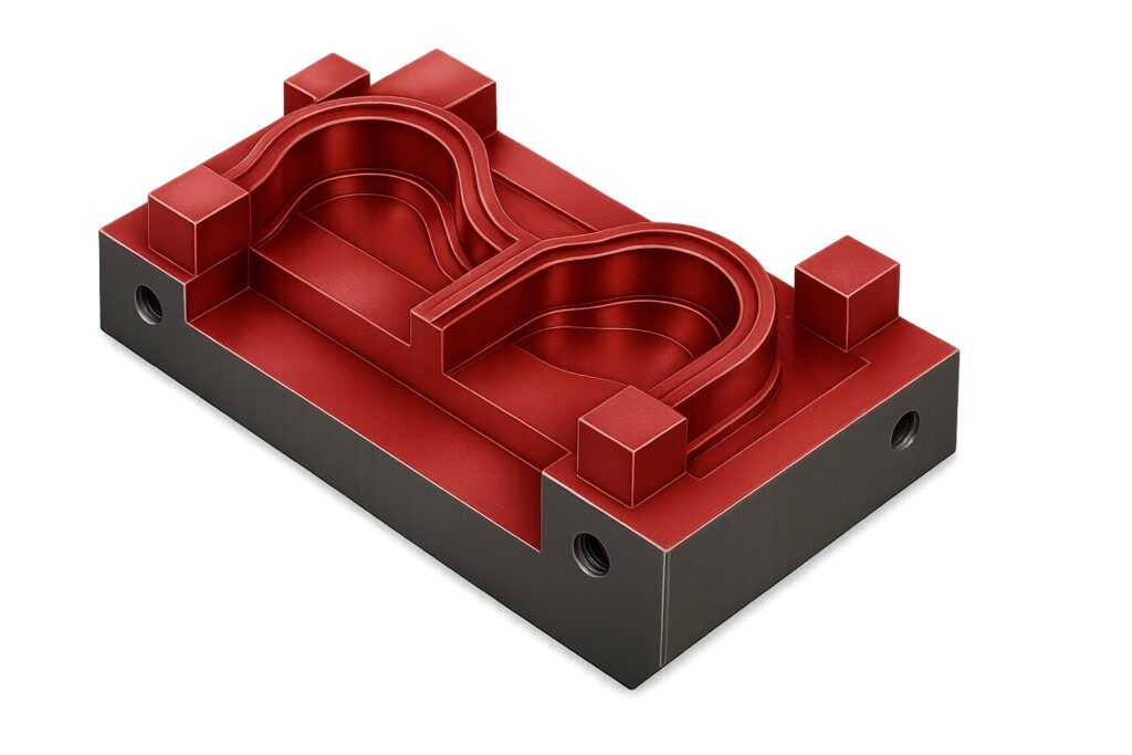

In mold machining, solid end mills had traditionally been used, but they posed challenges in achieving higher productivity.
The high-feed tool AddDoFeed enables stable high-feed machining even in small diameters, allowing increased depths of cut and feed rates compared with conventional tools.
In addition, the highly wear‑resistant AH8015 grade significantly extends tool life.
