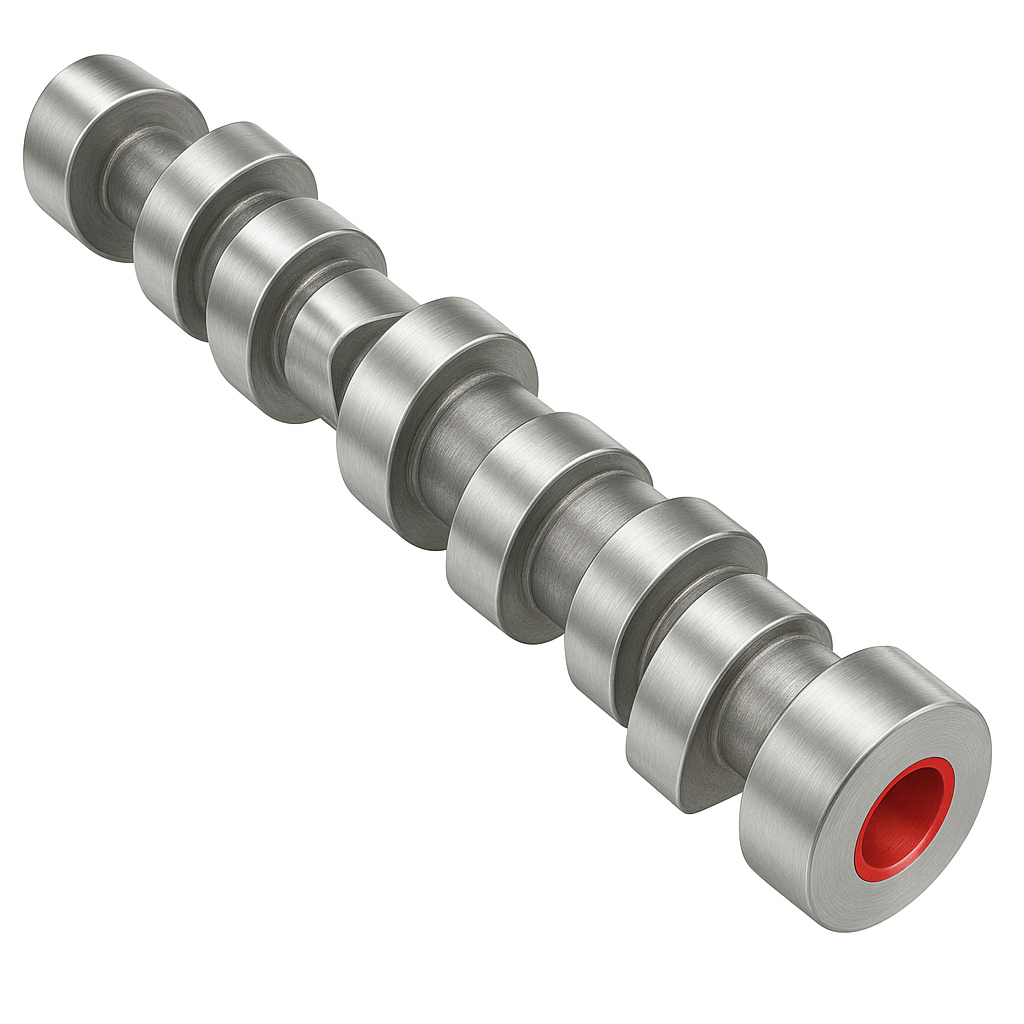

- TungSix-Drill is more economical due to 1.5 times higher number of cutting edges and improving tool life per edge.
Stable machining
- TungSix-Drill operates without any vibration and enables excellent chip control.
TungSix-Drill
Industry Oil & Gas
Component Valve
Work material 39NiCrMo5
Tool family Holemaking
Tool category Drilling
Product name TungSix-Drill
TSR No. 177D
Valve
Body TDS280F32-2 Indexable drill
Insert WWMU08X408R-DJ Square type insert
Grade AH9030 PVD
Tool diameter DC (mm) 28 28
Hole depth H (mm) 50 50
Cutting speed V/c (m/min) 180 180
Feed f (mm/rev) 0.18 0.18
Feed speed Vf (mm/min) 369 369
Coolant Water soluble(Internal) Water soluble(Internal)
Drilling length2.2 times
