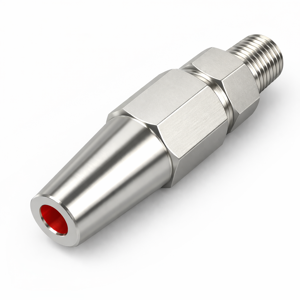

Industry | Oil & Gas |
Component | Valve |
Work material | 32CrMo4 |
Machine(spindle type) | Horizontal Machining Center |
Tool family | Holemaking |
Tool category | Drilling |
Product name | TungSix-Drill |
TSR No. | 120D |
Tungaloy | Competitor | |
Body | TDS320F32-3 | Indexable drill |
Insert | WWMU08X408R-DJ | Square type insert |
Grade | AH9030 | PVD |
Tool life (m/insert) | 123.6 | 70.4 |
Tool diameter DC (mm) | 32 | 32 |
Cutting speed V/c (m/min) | 200 | 225 |
Feed f (mm/rev) | 0.12 | 0.1 |
Feed speed Vf (mm/min) | 239 | 224 |
Coolant | Water soluble(internal) | Water soluble(internal) |
