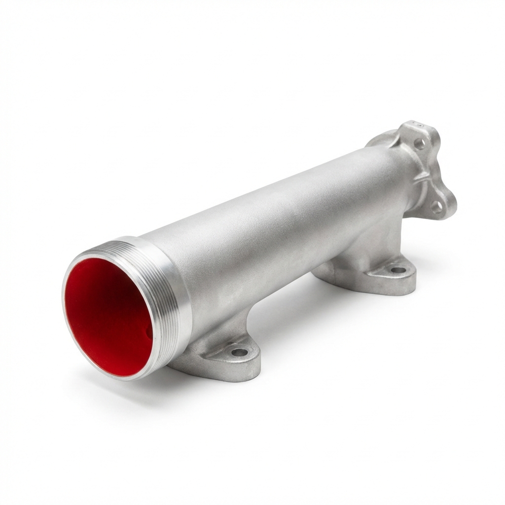

TungDrillTwisted – Valve – AH725
IMPROVED PRODUCTIVITY &CHIP CONTROL
- AH725 with “PremiumTec” significantly improves chip control.
- The excellent chip control reduces chip sedimentation and improves machining stability.
- Reduced cutting forces lead to a 40% increase in cutting speed and a 25% increase in feed.
Industry | Oil & Gas |
Component | Valve |
Work material | X2CrNiMo17-12-3 |
Tool family | Holemaking |
Tool category | Drilling |
Product name | TungDrillTwisted |
TSR No. | 022D |
Tungaloy | Competitor | |
Body | TDX230F25-2 | Indexable Drill |
Head | XPMT07H308R-DS | Square insert |
Insert | AH725 | P30 (PVD) |
Grade | AH725 | PVD |
Tool diameter DC (mm) | 23 | 23 |
Hole depth H (mm) | 25 | 25 |
Cutting speed V/c (m/min) | 140 | 100 |
Feed f (mm/rev) | 0.1 | 0.08 |
Feed speed Vf (mm/min) | 194 | 106 |
Coolant | Water soluble(Internal) | Water soluble(Internal) |
