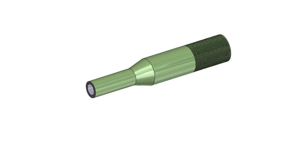

By applying back turning method with ADDMultiTurn the customer gained 4.5 times higher productivity in high- temp alloy. Since a longer cutting edge is in contact with workpiece during back turning application, the cutting temperature was kept from rising by efficiently dispersing cutting heat. As the result, double tool life was achieved.

Injector nozzle part
Holder ATXOR2525M25-A 25mm Square shank
Insert 6C-TOMG250608M-TM CNMG120408 With medium cutting geometry
Cutting speed V/c (m/min) 60 40
Feed f (mm/rev) 0.6 0.2
Depth of cut ap (mm) 1.5 1.5
Coolant Wet Wet
Productivity4.5 times
Tool life2 times
