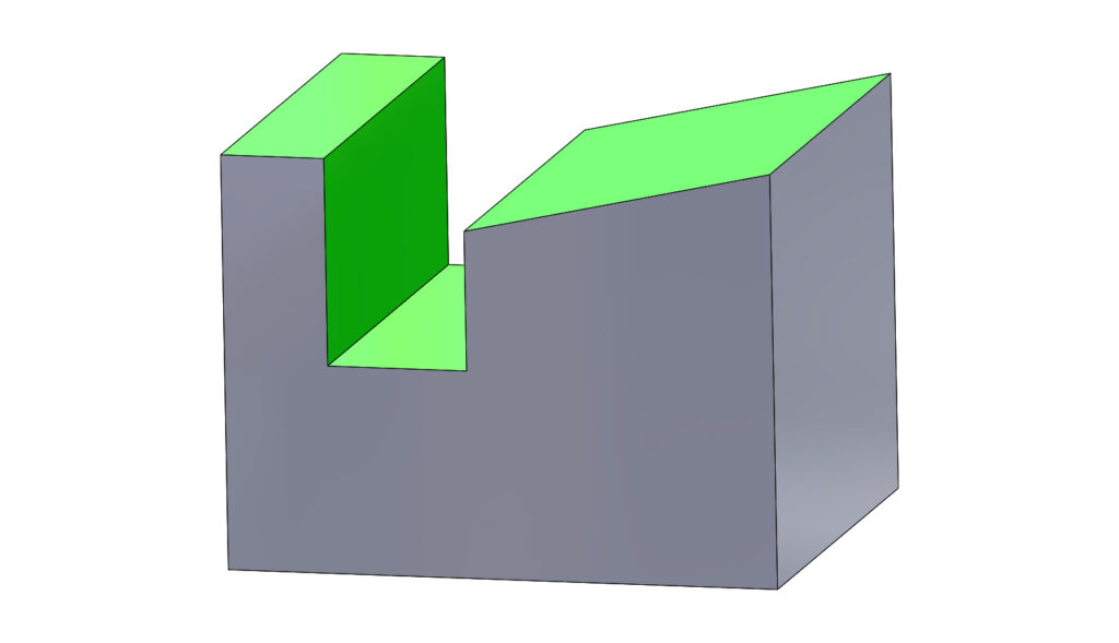

Component | Mold |
Work material | PXA30 |
Machine(spindle type) | Vertical Machining Center Middle(#40,HSK63) |
Tool family | Milling |
Tool category | Pocketing |
