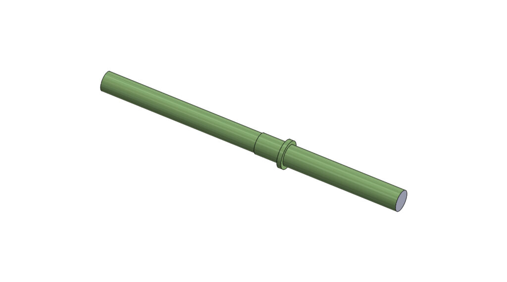

AddMultiTurn allowed the use of pull turning method at an increased feed rate of 0.8 mm/rev., which was an increase from 0.35 mm/rev with the competitor’s tool, providing 2.3 times productivity improvement while reducing machining time by over 70%. AddMultiTurn is the latest cutting tool series that enables all-directional turning for exceptional productivity.

Component | Rolling Roller Parts |
Work material | S45C |
