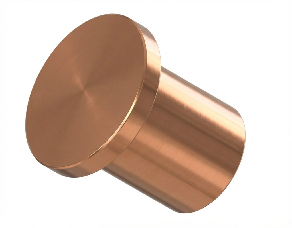

AddMultiTurn – Automotive part – T9215
New Internal coolant AddMultiTurn extend the tool life 4 times thanks to effective coolant supply with 4 MPa.
