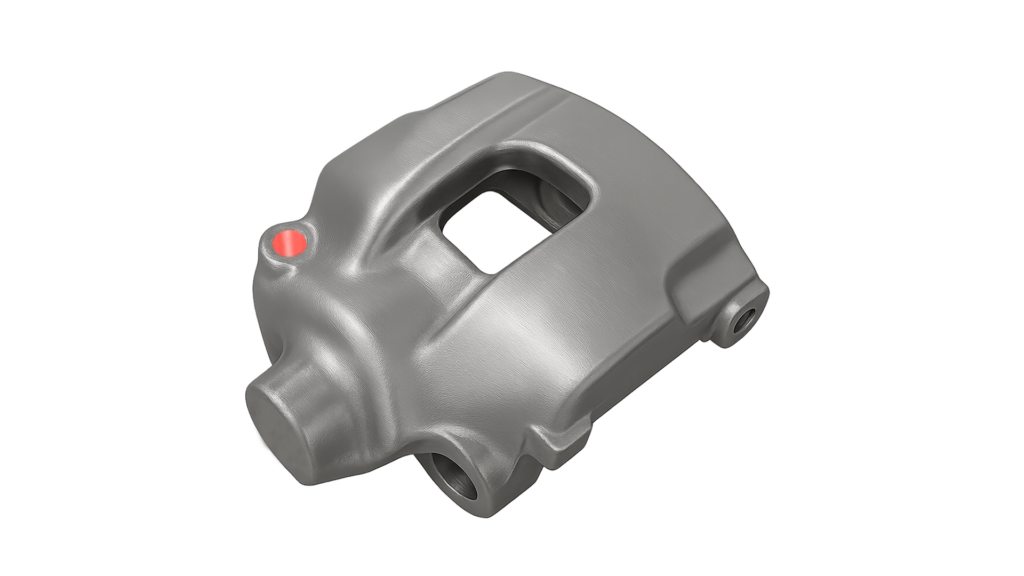

The grade AB060, which combines a heat-resistant TiAlN-based coating with powdered HSS material, delivers stable tool life even in high-speed cutting. Machining efficiency improved by 1.5 times.

Industry Automotive
Component Caliper
Work material DIN GG25
Machine(spindle type) Vertical Machining Center Middle(#40,HSK63)
Tool family Holemaking
Tool category Tapping
Product name TungTap
TSR No. 5216D
Caliper
Body TT-MF8X1-DNCG AB060 M8x1.0 HSS Tap
Grade AB060 TiCN + HSSE
Number of workpieces (pcs/insert) 2000 2000
Tool diameter DC (mm) M8x1.0 M8x1.0
Pilot hole diameter (mm) 7 7
Hole depth H (mm) 24 24
Cutting speed V/c (m/min) 30 20
Feed f (mm/rev) 1.0 1.0
Feed speed Vf (mm/min) 1194 796
Coolant External External
Productivity1.5 times
