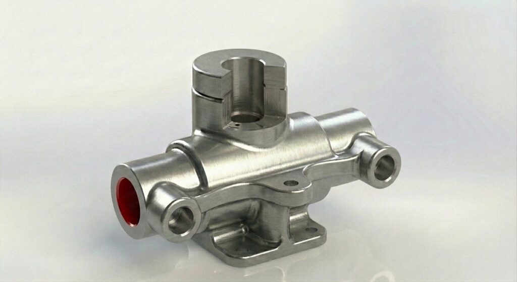

TungSixDrill – End bit – AH7030
The competitor's head exchangeable drill experienced tool breakage, requiring management with a short lifespan coefficient. In contrast, the TungSix-Drill, with its superior cutting edge strength, delivers stable tool life, extending lifespan by 3 times.
| Industry | Heavy |
| Component | End bit |
| Work material | Special alloy steel |
| Machine(spindle type) | Vertical Machining Center Large(#50,HSK100) |
| Tool category | Drilling |
| Product name | TungSix-Drill |
| TSR No. | 5133D |
| Body | TDS350F40-3 | Head changeable drill, 3xD |
| Insert | WWMU09X510R-DJ | Drill head |
| Grade | AH7030 | PVD, 1corner |
| Number of workpieces (pcs/insert) | 48 | 16 |
| Tool diameter DC (mm) | 35 | 29 |
| Hole depth H (mm) | 40 | 40 |
| Cutting speed V/c (m/min) | 97 | 82 |
| Feed speed Vf (mm/min) | 88 | 90 |
