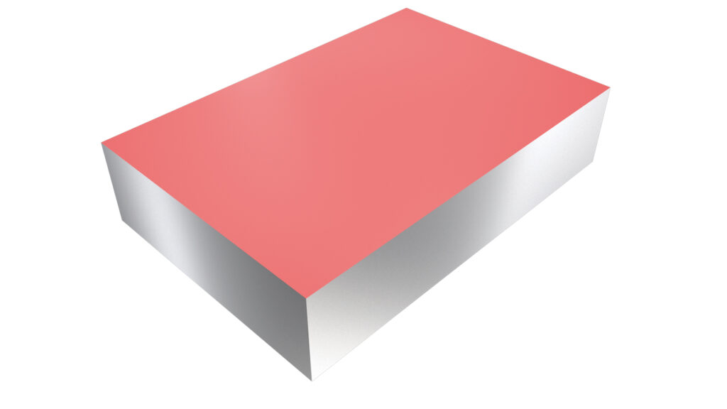

| Industry | Shipbuilding industry |
| Component | Plate |
| Work material | SACM645 |
| Machine(spindle type) | Horizontal Machining Center Large(#50,HSK100) |
