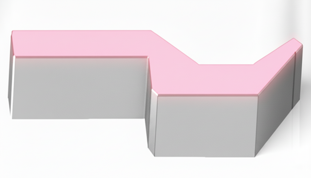

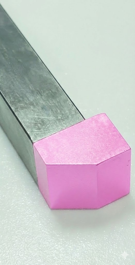

FinishMeister
Industry Machine Tool Builders
Component Blocks
Work material S45C
Machine(spindle type) Vertical Machining Center
Tool family Milling
Tool category Shoulder milling
Product name FinishMeister
TSR No. 5025M
Blocks
Body TEFS160B44-34C16-92 Solid Endmill
Effective number of teeth 4 2
Cutting diameter 16 16
Overhang (mm) 50 50
Number of cutting edges 1 1
Grade AH725 PVD
Cutting speed V/c (m/min) 100 120
Feed per tooth f/z (mm/t) 0.15 0.1
Feed f (mm/rev) 0.6 0.2
Feed speed Vf (mm/min) 1194 477
Depth of cut ap (mm) 30 5
Width of cut ae (mm) 4 4
Coolant Dry Dry
Productivity14 times
