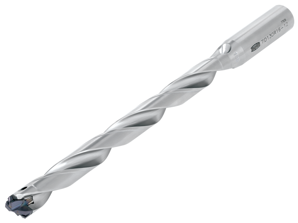

The DrillMeister DMC head achieved the same tool life of 150 holes as the conventional solid carbide drill while increasing drilling depth from 65 mm to 80 mm and improving the feed rate by approximately 36%. Stable drilling without hole-position deviation was achieved through six stacked plates, and machining time per hole was reduced by approximately 9%, demonstrating improved productivity and process stability.
